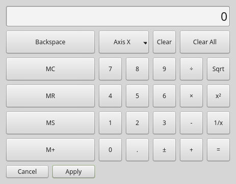

2.4. AxisToolButton
- Select and Set Axis Widget
This allows one to select and set an axis.
If the button is set checkable, it will indicate which axis is selected.
If you press and hold the button a pop up menu will show allowing one to:
Zero the axis
Divide the axis by 2
Set the axis arbitrarily
Reset the axis to the last number recorded
You must have selected an entry dialog that corresponds to the dialog_code_string, usually this is selected from the screenOptions widget.
You can select the property halpin_option, it will then set a HAL pin true when the axis is selected. The property joint_number should be set to the appropriate joint number. The property axis_letter should be set to the appropriate axis letter.
The property dialog_code_string can be changed to ENTRY or CALCULATOR to call a typing only entry dialog or a touch/typing calculator type entry dialog.
It is based on PyQt’s QToolButton.

Calc
will pop up a calculator dialog. -

3.9. CalculatorDialog
- Calculator Dialog Widget
CalculatorDialog
: Calculator Dialog WidgetThis is a dialog to display a calculator for numeric entry, such as origin offset.
It returns the entry via STATUS
messages using a Python DICT
The DICT
contains at minimum, the name of the dialog requested and an ID code.
When using ``STATUS``'s request-dialog
function, the default launch name is CALCULATOR
It is based on PyQt’s QDialog.
