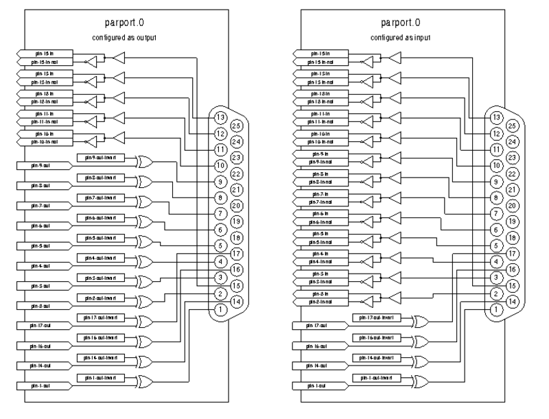

Parport block diagram
Figure 1. Parport block diagram
