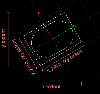

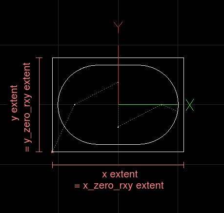

graphics-gcode-properties
(returns Python dict) - Sent when G-code is loaded.
The dict contains the following keys:
  • name (string): Name of the loaded file
  • size (string): Size in bytes and lines
  • g0 (string): Total rapid distance
  • g1 (string): Total feed distance
  • run (string): Estimated program run time
  • toollist (list): List of used tools
  • x (string): X extents (bounds) 1
  • x_zero_rxy (string): X extents without rotation around z (bounds) 1
  • y (string): Y extents (bounds) 1
  • y_zero_rxy (string): Y extents without rotation around z (bounds) 1
  • z (string): Z extents (bounds) 1
  • z_zero_rxy (string): Z extents without rotation around z (bounds) 1
  • machine_unit_sys (string): Machine units (Metric or Imperial)
  • gcode_units (string): Units in G-code file (mm or in)
    Note
    1. See the images extends non-rotated and extends rotated 30 for a better understanding.
