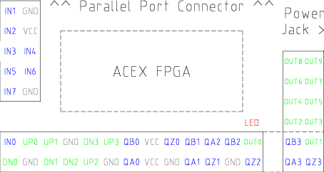

2.1. Pinout
  • UPx - The up (up/down mode) or pwm (pwm+direction mode) signal from PWM generator X. May be used as a digital output if the corresponding PWM channel is unused, or the output on the channel is always negative. The corresponding digital output invert may be set to TRUE to make UPx active low rather than active high.
  • DNx - The down (up/down mode) or direction (pwm+direction mode) signal from PWM generator X. May be used as a digital output if the corresponding PWM channel is unused, or the output on the channel is never negative. The corresponding digital output invert may be set to TRUE to make DNx active low rather than active high.
  • QAx, QBx - The A and B signals for Quadrature counter X. May be used as a digital input if the corresponding quadrature channel is unused.
  • QZx - The Z (index) signal for quadrature counter X. May be used as a digital input if the index feature of the corresponding quadrature channel is unused.
  • INx - Dedicated digital input #x
  • OUTx - Dedicated digital output #x
  • GND - Ground
  • VCC - +3.3V regulated DC
Pluto-Servo Pinout
Figure 1. Pluto-Servo Pinout

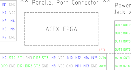

3.1. Pinout
  • STEPx - The step (clock) output of stepgen channel x
  • DIRx - The direction output of stepgen channel x
  • GND - Ground
While the extended main connector has a superset of signals usually found on a Step & Direction DB25 connector—4 step generators, 9 inputs, and 6 general-purpose outputs—the layout on this header is different than the layout of a standard 26-pin ribbon cable to DB25 connector.
Pluto-Step Pinout
Figure 2. Pluto-Step Pinout

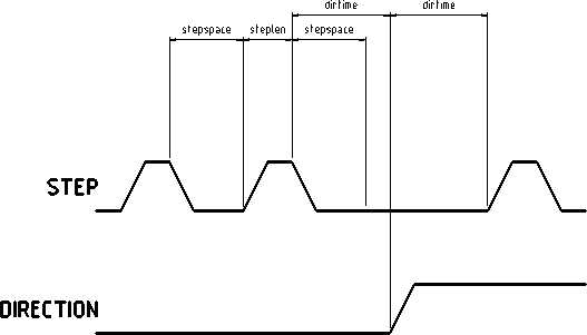

3.3. Step Waveform Timings
The firmware and driver enforce step length, space, and direction change times. Timings are rounded up to the next multiple of 1.6μs, with a maximum of 49.6μs. The timings are the same as for the software stepgen component, except that dirhold and dirsetup have been merged into a single parameter dirtime which should be the maximum of the two, and that the same step timings are always applied to all channels.
Pluto-Step Timings
Figure 3. Pluto-Step Timings
