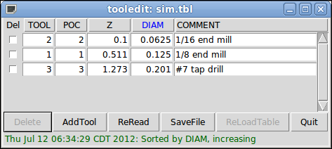

2. Column Sorting
The tool table display can be sorted on any column in ascending order by clicking on the column header. A second click sorts in descending order. Column sorting requires that the machine is configured with the default tcl version >= 8.5.
images/tooledit-sort.png
On Ubuntu Lucid 10.04 tcl/tk8.4 is the default. You can add tcl/tk8.5 with the commands:
sudo apt-get install tcl8.5 tk8.5
Depending upon other applications installed on the system, it may be necessary to enable tcl/tk8.5 with the commands:
sudo update-alternatives --config tclsh  ;# select the option for tclsh8.5
sudo update-alternatives --config wish   ;# select the option for wish8.5

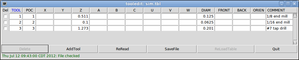

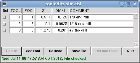

3. Column Selection
By default, the tooledit program will display all possible tool table parameter columns. Since few machines use all parameters, the columns displayed can be limited with the following ini file setting:
images/tooledit-columns.png
INI File Syntax
[DISPLAY]
TOOL_EDITOR = tooledit column_name column_name ...
Example for Z and DIAM columns
[DISPLAY]
TOOL_EDITOR = tooledit Z DIAM
