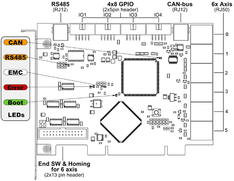

The following connectors can be found on the GM6-PCI card:
images/GM_PCIpinout.png
Figure 1. GM6-PCI card connectors and LEDs

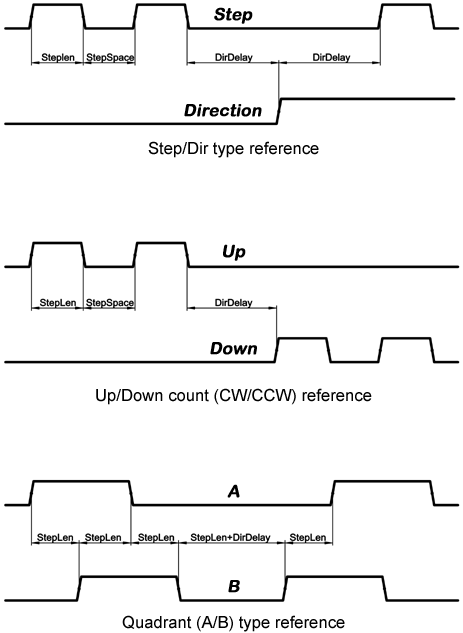

.dirdelay
(u32, R/W)
Minimum time between step pulse and direction change in nano-seconds.
For evaluating the appropriate values see the timing diagrams below:
images/GM_RefSignals.png
Figure 5. Reference signal timing diagrams
HAL example
Setting stepgen module of axis 0 to generate 1000 step pulse per position unit:
setp gm.0.stepgen.0.step-type 0         # 0:stepDir, 1:UpDown, 2:Quad
setp gm.0.stepgen.0.control-type 0      # 0:Pos. control, 1:Vel. Control
setp gm.0.stepgen.0.invert-step1 0
setp gm.0.stepgen.0.invert-step2 0
setp gm.0.stepgen.0.maxvel 0            # do not set maxvel for step
                                        # generator, let interpolator control it.
setp gm.0.stepgen.0.maxaccel 0          # do not set max acceleration for
                                        # step generator, let interpolator control it.
setp gm.0.stepgen.0.position-scale 1000 # 1000 step/position unit
setp gm.0.stepgen.0.steplen 1000        # 1000 ns = 1 us
setp gm.0.stepgen.0.stepspace1000       # 1000 ns = 1 us
setp gm.0.stepgen.0.dirdelay 2000       # 2000 ns = 2 us

5. End-, homing- and E-stop switches
images/GM_ENDSWpinout.png
Figure 6. Pin numbering of homing & end switch connector
Table 16. End- and homing switch connector pinout
25 23 21 19 17 15 13 11 9 7 5 3 1
GND
1/End-
2/End+
2/Hom-ing
3/End-
4/End+
4/Hom-ing
5/End-
6/End+
6/Hom-ing
E-Stop 2
V+ (Ext.)
26 24 22 20 18 16 14 12 10 8 6 4 2
GND
1/End+
1/Hom-ing
2/End-
3/End+
3/Hom-ing
4/End-
5/End+
5/Hom-ing
6/End-
E-Stop 1
V+ (Ext.)

6. Status LEDs
6.1. CAN
Color: Orange
  • Blink, during data communication.
  • On, when any of the buffers are full - communication error.
  • Off, when no data communication.
6.2. RS485
Color: Orange
  • Blink, during initialization of modules on the bus
  • On, when the data communication is up between all initialized modules.
  • Off, when any of the initialized modules dropped off because of an error.
6.3. EMC
Color: White
  • Blink, when LinuxCNC is running.
  • Otherwise off.
6.4. Boot
Color: Green
  • On, when system booted successfully.
  • Otherwise off.
6.5. Error
Color: Red
  • Off, when there is no fault in the system.
  • Blink, when PCI communication error.
  • On, when watchdog timer overflowed.

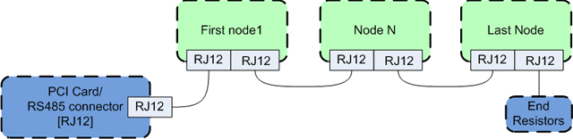

7. RS485 I/O expander modules
These modules were developed for expanding the I/O and function capability along an RS485 line of the GM6-PCI motion control card.
Available module types:
  • 8-channel relay output module - gives eight NO-NC relay output on a three pole terminal connector for each channel.
  • 8-channel digital input module - gives eight optical isolated digital input pins.
  • 8 channel ADC and 4-channel DAC module - gives four digital-to-analogue converter outputs and eight analogue-to-digital inputs. This module is also optically isolated from the GM6-PCI card.
Automatic node recognizing:
Each node connected to the bus was recognized by the GM6-PCI card automatically. During starting LinuxCNC, the driver export pins and parameters of all available modules automatically.
Fault handling:
If a module does not answer regularly the GM6-PCI card drops down the module. If a module with output do not gets data with correct CRC regularly, the module switch to error sate (green LED blinking), and turns all outputs to error sate.
Connecting the nodes:
The modules on the bus have to be connected in serial topology, with termination resistors on the end. The start of the topology is the PCI card, and the end is the last module.
images/GM_RS485topology.png
Figure 7. Connecting the RS485 nodes to the GM6-PCI card
Adressing:
Each node on the bus has a 4 bit unique address that can be set with a red DIP switch.
Status LED:
A green LED indicates the status of the module:
  • Blink, when the module is only powered, but not jet identified, or when module is dropped down.
  • Off, during identification (computer is on, but LinuxCNC not started)
  • On, when it communicates continuously.
