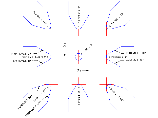

3. Lathe Tool Orientation
The following figure shows the lathe tool orientations with the center line angle of each orientation and info on FRONTANGLE and BACKANGLE. The FRONTANGLE and BACKANGLE are clockwise starting at a line parallel to Z+.
images/tool_positions.png
Figure 1. Lathe Tool Orientations
In AXIS the following figures show what the Tool Positions look like, as entered in the tool table.
images/tool_pos_1.png
Figure 2. Tool Positions 1, 2, 3 & 4
images/tool_pos_2.png
images/tool_pos_3.png
images/tool_pos_4.png
images/tool_pos_5.png
Figure 3. Tool Positions 5, 6, 7 & 8
images/tool_pos_6.png
images/tool_pos_7.png
images/tool_pos_8.png

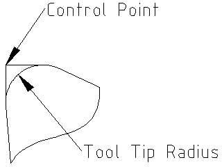

7.1. Control Point

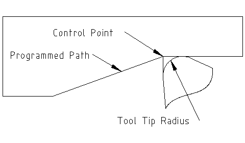

The control point for the tool follows the programmed path. The control point is the intersection of a line parallel to the X and Z axis and tangent to the tool tip diameter, as defined when you touch off the X and Z axes for that tool. When turning or facing straight sided parts the cutting path and the tool edge follow the same path. When turning radius and angles the edge of the tool tip will not follow the programmed path unless cutter comp is in effect. In the following figures you can see how the control point does not follow the tool edge as you might assume.
images/control_point.png
Figure 4. Control Point

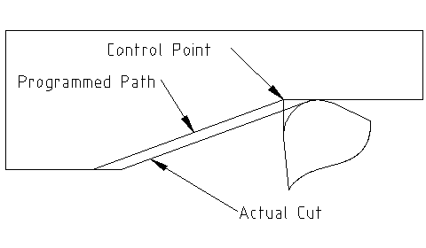

7.2. Cutting Angles without Cutter Comp
Now imagine we program a ramp without cutter comp. The programmed path is shown in the following figure. As you can see in the figure the programmed path and the desired cut path are one and the same as long as we are moving in an X or Z direction only.
images/ramp_entry.png
Figure 5. Ramp Entry
Now as the control point progresses along the programmed path the actual cutter edge does not follow the programmed path as shown in the following figure. There are two ways to solve this, cutter comp and adjusting your programmed path to compensate for tip radius.
images/ramp_cut.png
Figure 6. Ramp Path
In the above example it is a simple exercise to adjust the programmed path to give the desired actual path by moving the programmed path for the ramp to the left the radius of the tool tip.

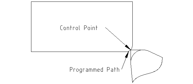

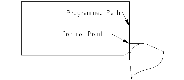

7.3. Cutting a Radius
In this example we will examine what happens during a radius cut without cutter comp. In the next figure you see the tool turning the OD of the part. The control point of the tool is following the programmed path and the tool is touching the OD of the part.
images/radius_1.png
Figure 7. Turning Cut

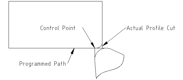

In this next figure you can see as the tool approaches the end of the part the control point still follows the path but the tool tip has left the part and is cutting air. You can also see that even though a radius has been programmed the part will actually end up with a square corner.
images/radius_2.png
Figure 8. Radius Cut
Now you can see as the control point follows the radius programmed the tool tip has left the part and is now cutting air.
images/radius_3.png
Figure 9. Radius Cut

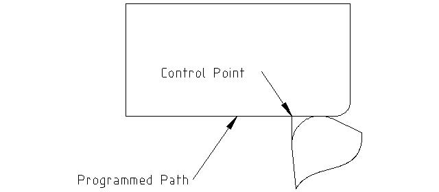

In the final figure we can see the tool tip will finish cutting the face but leave a square corner instead of a nice radius. Notice also that if you program the cut to end at the center of the part a small amount of material will be left from the radius of the tool. To finish a face cut to the center of a part you have to program the tool to go past center at least the nose radius of the tool.
images/radius_4.png
Figure 10. Face Cut
