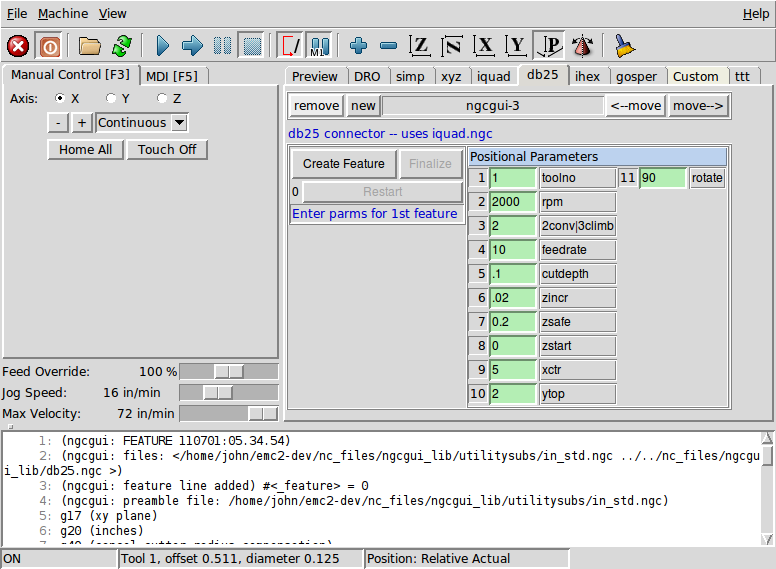

  • Tab pages are provided for subroutines specified in the INI file
  • New subroutines tab pages can be added using Custom tab pages
  • Each subroutine tab page provides entry boxes for all subroutine parameters
  • The entry boxes can have a default value and an label that are identified by special comments in the subroutine file

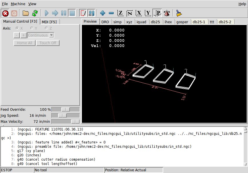

  • Subroutine invocations are concatenated together to form a multiple step program
  • Any single-file gcode subroutine that conforms to ngcgui conventions can be used

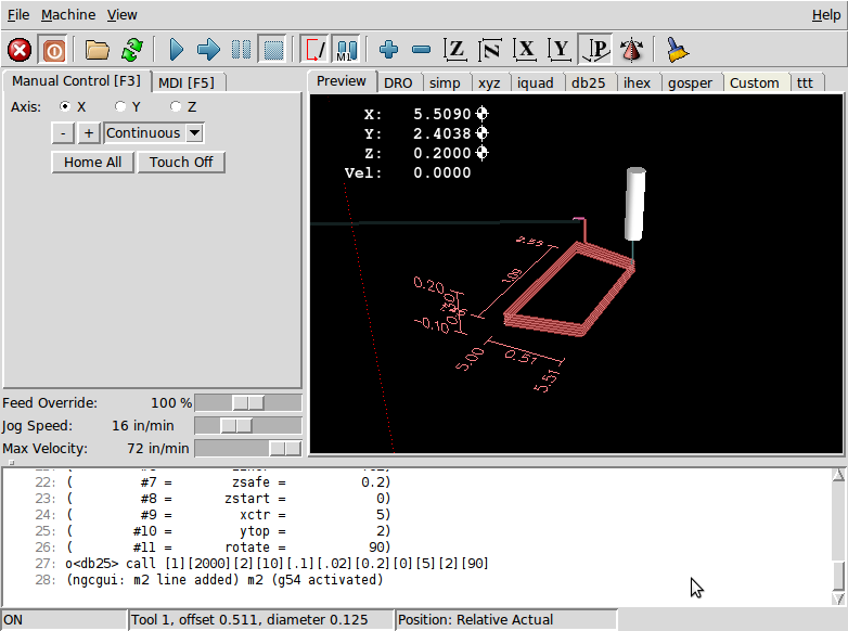

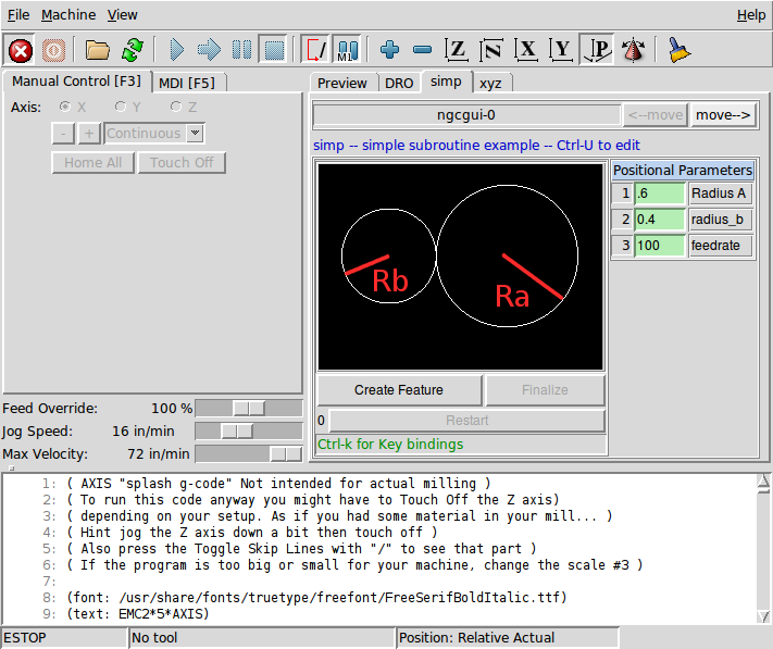

The simplest application is found as:
Sample Configurations / sim / axis / ngcgui /ngcgui_simple
A comprehensive example showing gcmc compatibility is at:
Sample Configurations / sim / axis / ngcgui / ngcgui_gcmc
A comprehensive example embedded as a gladevcp app and using gcmc is at:
Sample Configurations / sim / gscreen / ngcgui / pyngcgui_gcmc
The example sim configurations make use of library files that provide example gcode subroutine (.ngc) files and Gcode-meta-compiler (.gcmc) files:
  • nc_files/ngcgui_lib

    • simp.ngc - a simple subroutine example that creates two circles

To try a demonstration, select a sim configuration and start the linuxCNC program.
If using the axis gui, press the E-Stop images/tool_estop.gif then Machine Power images/tool_power.gif then Home All. Pick a ngcgui tab, fill in any empty blanks with sensible values and press Create Feature then Finalize. Finally press the Run images/tool_run.gif button to watch it run. Experiment by creating multiple features and features from different tab pages.
Other guis will have similar functionality but the buttons and names may be different.

7. DB25 Example
The following shows the DB25 subroutine. In the first photo you see where you fill in the blanks for each variable.
images/ngcgui-db25-1.png
This photo shows the backplot of the DB25 subroutine.
