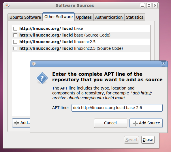

1. Updating from 2.5.x to 2.6.x
First you need to tell your computer where to find the new LinuxCNC software:
Click on the System menu in the top panel and select Administration->Software Sources.
Select the Other Software tab.
Disable or delete all the old linuxcnc.org entries.
Add a new Apt line that looks like this:
deb http://linuxcnc.org/ lucid base 2.6
images/updating-lucid-to-2.6.png
When you add that line, Software Sources will pop up a window informing you that the information about available software is out-of-date. Click the Reload button.
Now your computer knows about the new software, next we need to tell it to install it:
  • Click on the System menu in the top panel and select Administration->Synaptic Package Manager
  • In the Quick Search bar at the top, type linuxcnc.
  • Click the check box to mark the new linuxcnc package for installation.
  • Click the Apply button, and let your computer install the new package. The old linuxcnc 2.5 package will be automatically upgraded to the new linuxcnc 2.6 package.
