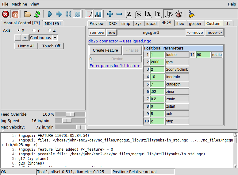

1. Overview
  • NGCGUI is a utility for using LinuxCNC subroutines.
  • NGCGUI can run as a standalone application or be embedded in multiple tab pages in the axis gui
  • Multiple copies of the same subroutine can be created
  • Subroutines can be concatenated together to form a complete multiple step program
  • New subroutines can be added on the fly
NGCGUI is a powerful tool for building g-code programs from subroutines on the fly. Subroutines can be concatenated to build a complete program. Multiple instances of a subroutine can be used to perform the same task in different locations on the part. Any valid g-code can be used in the subroutine.
2. Demo Configs
Three demo configurations are are located in the sim directory of the LinuxCNC configuration picker. The configuration picker is on the main menu Applications > CNC > LinuxCNC.

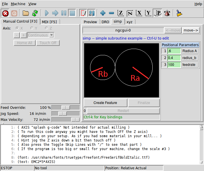

  • ngcgui - a comprehensive example that contains these subroutines
    • simp - a simple subroutine example that creates two circles
    • xyz - creates a box based on two opposite corners
    • iquad - creates an internal quadrilateral

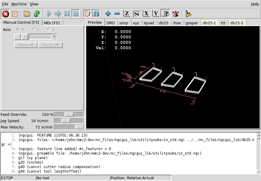

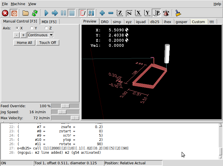

    • db25 - creates a DB25 plug cutout
    • ihex - creates an interal hexagon
    • gosper - a recursion demo
    • Custom - load other ngcgui-compatible subfiles
    • ttt - True Type Tracer creates text for engraving
  • ngcgui-lathe - an example with lathe subroutines
    • id - bores the inside diameter
    • od - turns the outside diameter
    • taper-od - turns a taper on the outside diameter
    • Custom - creates custom tabs
  • ngcgui-simple - a simple example
To view the demonstration subroutines press the E-Stop images/tool_estop.gif then Machine Power images/tool_power.gif then Home All. Pick a ngcgui tab and press Create Feature then Finalize. Now press the Run images/tool_run.gif button to watch it run.

6. DB25 Example
The following shows the DB25 subroutine. In the first photo you see where you fill in the blanks for each variable.
images/ngcgui-db25-1.png
This photo shows the backplot of the DB25 subroutine.
images/ngcgui-db25-2.png
This photo shows the use of the new button and the custom tab to create three DB25 cutouts in one program.
images/ngcgui-db25-3.png
