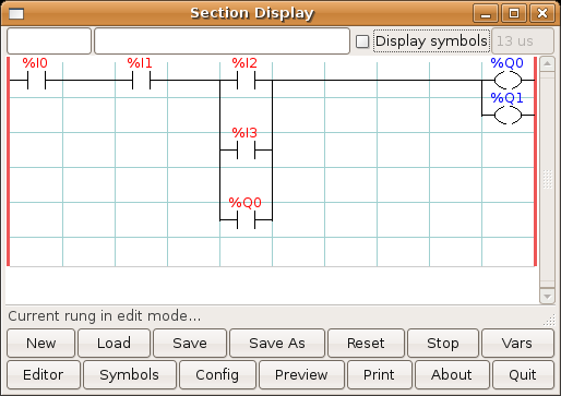

Next we run our config and build the ladder as shown here.
Figure: E-Stop Section Display
After building the ladder select Save As and save the ladder as estop.clp

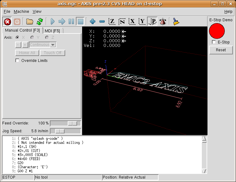

Now start up your config and it should look like this.
Figure: AXIS E-Stop
Note that in this example like in real life you must clear the remote E-Stop (simulated by the checkbox) before the AXIS E-Stop or the external Reset will put you in OFF mode. If the E-Stop in the AXIS screen was pressed you must press it again to clear it. You cannot reset from the external after you do an E-Stop in AXIS.
