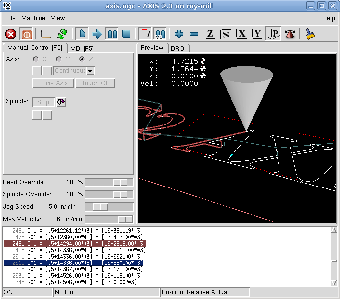

AXIS is a graphical front-end for EMC2 which features a live preview and backplot. It is written in Python and uses Tk and OpenGL to display its user interface.
Figure: AXIS Window
1.2 Getting Started
To select AXIS as the front-end for EMC2, edit the .ini file. In the section [DISPLAY] change the DISPLAY line to read
DISPLAY = axis
Then, start EMC2 and select that ini file. The sample configuration sim/axis.ini is already configured to use AXIS as its front-end.
When you start AXIS, a window like the one in Figure [.] is shown.

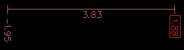

The "extents" of the program in each axis are shown. At each end, the least or greatest coordinate value is indicated. In the middle, the difference between the coordinates is shown. In Figure ([.]), the X extent of the file is from 0.00 to 6.92 inches, a total of 6.92 inches.
When some coordinates exceed the "soft limits" in the .ini file, the relevant dimension is shown in a different color and enclosed by a box. In Figure ([.]) the maximum soft limit is exceeded on the X axis as indicatated by the box surrounding the coordinate value.

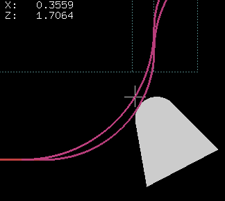

The location of the tip of the tool is indicated by the "tool cone". The cone does not indicate anything about the shape, length, or radius of the tool.
When a tool is loaded (for instance, with the MDI command T1M6), the cone changes to a cylinder which shows the diameter of the tool given in the tool table file.

1.3.4 Text Display Area
By left-clicking a line of the program, the line will be highlighted in both the graphical and text displays in blue.
When the program is running, the line currently being executed is highlighted in red. If no line has been selected by the user, the text display will automatically scroll to show the current line.
Figure: Current and Selected Lines

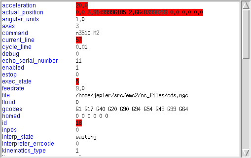

1.5 Show EMC Status
AXIS includes a program called "emctop" which shows some of the details of EMC's state. You can run this program by invoking Machine > Show EMC Status
Figure: EMC Status Window
The name of each item is shown in the left column. The current value is shown in the right column. If the value has recently changed, it is shown on a red background.

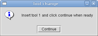

1.8 Manual Tool Change
EMC2 includes a userspace hal component called "hal_manualtoolchange", which shows a window (Figure [.]) when a M6 command is issued. After the OK button is pressed, execution of the program will continue.
The HAL configuration file configs/sim/axis_manualtoolchange.hal shows the HAL commands necessary to use this component.
hal_manualtoolchange can be used even when AXIS is not used as the GUI. This component is most useful if you have presettable tools and you use the tool table.
Important Note: Rapids will not show on the preview after a T<n> is issued until the next feed move after the M6. This can be very confusing to most users. To turn this feature off for the current tool change program a G1 with no move after the T<n>.
Figure: The Manual Toolchange Window

1.10 Lathe Mode
By including the line
LATHE=1
in the [DISPLAY] section of the ini file, AXIS selects lathe mode. The "Y" axis is not shown in coordinate readouts, the view is changed to show the Z axis extending to the right and the X axis extending towards the bottom of the screen, and several controls (such as those for preset views) are removed.
Pressing "V" zooms out to show the entire file, if one is loaded.
When in lathe mode, the shape of the loaded tool (if any) is shown.
Figure: Lathe Tool Shape

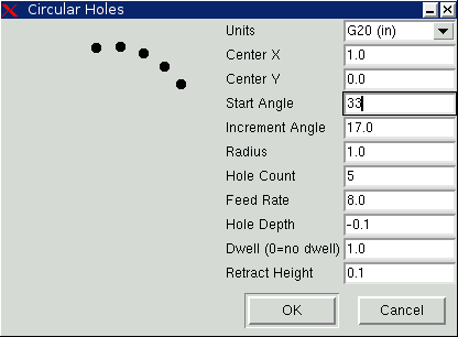

It is also possible to specify an interpreter:
py = python
In this way, any Python script can be opened, and its output is treated as g-code. One such example script is available at nc_files/holecircle.py. This script creates g-code for drilling a series of holes along the circumference of a circle.
Figure: Circular Holes
