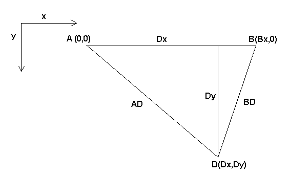

To illustrate the above, we will analyze a simple kinematics called bipod (a simplified version of the tripod, which is a simplified version of the hexapod).
The Bipod we are talking about is a device that consists of 2 motors
placed on a wall, from which a device is hanged using some wire. The
joints in this case are the distances from the motors to the device
(named AD and BD in figure ![[*]](crossref.png) ).
The position of the motors is fixed by convention. Motor A is in (0,0), which means that its X coordinate is 0, and its Y coordinate is also 0. Motor B is placed in (Bx, 0), which means that its X coordinate is Bx.
Our tooltip will be in point D which gets defined by the distances AD and BD, and by the Cartesian coordinates Dx, Dy.
The job of the kinematics is to transform from joint lengths (AD, BD) to Cartesian coordinates (Dx, Dy) and vice-versa.
To transform from joint space into Cartesian space we will use some trigonometry rules (the right triangles determined by the points (0,0), (Dx,0), (Dx,Dy) and the triangle (Dx,0), (Bx,0) and (Dx,Dy).
we can easily see that AD2 = x2 + y2, likewise BD2 = (Bx - x)2 + y2.
If we subtract one from the other we will get:
and therefore:
From there we calculate:
Note that the calculation for y involves the square root of a difference, which may not result in a real number. If there is no single Cartesian coordinate for this joint position, then the position is said to be a singularity. In this case, the forward kinematics return -1.

The inverse kinematics is lots easier in our example, as we can write it directly:
or translated to actual code:
