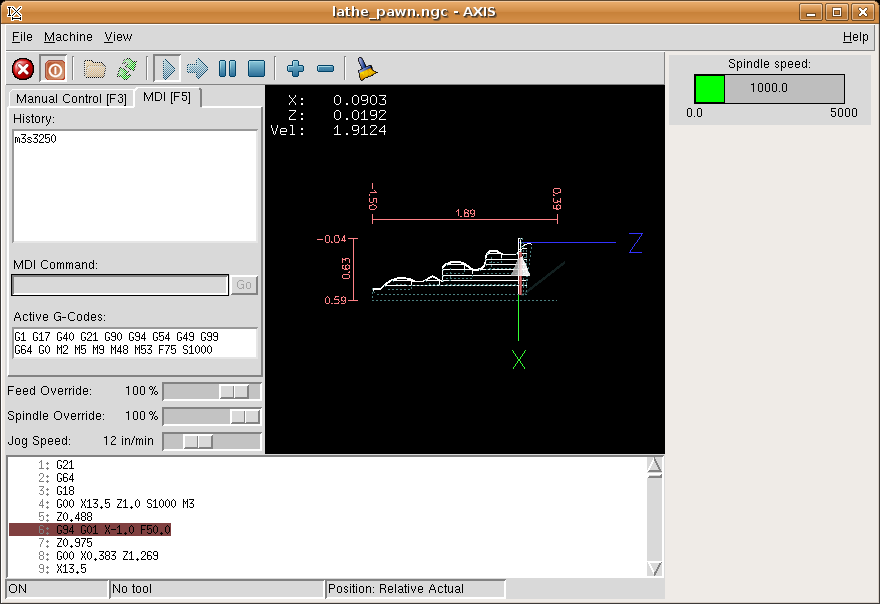

Using pyVCP with AXIS
Since AXIS uses the same GUI toolkit (Tkinter) as pyVCP, it is possible to include a pyVCP panel on the right side of the normal AXIS user interface. A typical example is explained below.
Place your pyVCP XML file describing the panel in the same directory where your .ini file is. Say we we want to display the current spindle speed using a Bar widget. Place the following in a file called spindle.xml:
<pyvcp>
    <label>
        <text>"Spindle speed:"</text>
    </label>
    <bar>
        <halpin>"spindle-speed"</halpin>
        <max_>5000</max_>
    </bar>
</pyvcp>
Here we've made a panel with a Label and a Bar widget, specified that the HAL pin connected to the Bar should be named ``spindle-speed'', and set the maximum value of the bar to 5000 (see widget reference below for all options). To make AXIS aware of this file, and call it at startup, we need to specify the following in the [DISPLAY] section of the .ini file:
PYVCP = spindle.xml
To make our widget actually display the spindle-speed it needs to be hooked up to the appropriate HAL signal. A .hal file that will be run once AXIS and pyVCP have started can be specified in the [HAL] section of the .ini file:
POSTGUI_HALFILE = spindle_to_pyvcp.hal
This change will run the HAL commands specified in ``spindle_to_pyvcp.hal''. In our example the contents could look like this:
linksp spindle-rpm-filtered  pyvcp.spindle-speed
assuming that a singlal called ``spindle-rpm-filtered'' already exists. Note that when running together with AXIS, all pyVCP widget HAL pins have names that start with ``pyvcp.''.
Image pyvcp_AXIS
This is what the newly created pyVCP panel should look like in AXIS.

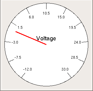

Meter
Meter displays the value of a FLOAT signal using a traditional dial indicator.
<meter>
    <halpin>"my-meter"</halpin>
    <text>"Voltage"</text>
    <size>300</size>
    <min_>-12</min_>
    <max_>33</max_>
</meter>
Image pyvcp_meter
