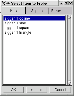

Using halmeter
The meter in figure [*] isn't very useful, because it isn't displaying anything. To change that, click on the 'Select' button, which will open the probe selection dialog (figure [*]).
Figure: Halmeter source selection dialog
Image halmeter-demo-2
This dialog has three tabs. The first tab displays all of the HAL pins in the system. The second one displays all the signals, and the third displays all the parameters. We would like to look at the pin siggen.0.triangle first, so click on it then click the 'OK' button. The probe selection dialog will close, and the meter looks something like figure [*].
Figure: Halmeter displaying the value of a pin
Image halmeter-demo-3
You should see the value changing as siggen generates its triangle wave. Halmeter refreshes its display about 5 times per second.
If you want to quickly look at a number of pins, you can use the 'Accept' button in the source selection dialog. Click on 'Select' to open the dialog again. This time, click on another pin, like siggen.0.cosine, and then click 'Accept'. When you click 'Accept', the meter immediately begins to display the newly selected item, but the dialog does not close. Try displaying a parameter instead of a pin. Click on the 'Parameters' tab, then select a parameter and click 'Accept' again. You can very quickly move the ``meter probes'' from one item to the next with a couple of clicks.
To shut down halmeter, just click the exit button.

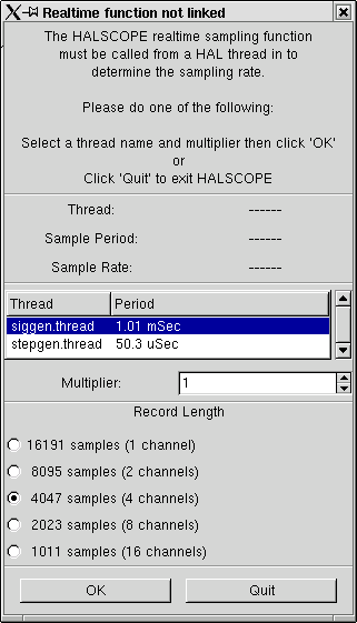

Halscope has two parts - a realtime part that is loaded as a kernel module, and a user part that supplies the GUI and display. However, you don't need to worry about this, because the userspace portion will automatically request that the realtime part be loaded.
halcmd: loadusr halscope
The scope GUI window will open, immediately followed by a ``Realtime function not linked'' dialog that looks like figure [*]1.5.
Figure: ``Realtime function not linked'' dialog
Image halscope-demo-1
This dialog is where you set the sampling rate for the oscilloscope. For now we want to sample once per millisecond, so click on the 1.03mS thread ``slow'' (formerly ``siggen.thread'', see footnote), and leave the multiplier at 1. We will also leave the record length at 4047 samples, so that we can use up to four channels at one time. When you select a thread and then click ``OK'', the dialog disappears, and the scope window looks something like figure [*].

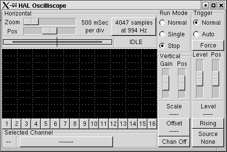

Figure: Initial scope window
Image halscope-demo-2
Hooking up the ``scope probes''
At this point, Halscope is ready to use. We have already selected a sample rate and record length, so the next step is to decide what to look at. This is equivalent to hooking ``virtual scope probes'' to the HAL. Halscope has 16 channels, but the number you can use at any one time depends on the record length - more channels means shorter records, since the memory available for the record is fixed at approximately 16,000 samples.

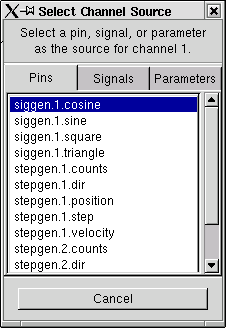

The channel buttons run across the bottom of the halscope screen. Click button ``1'', and you will see the ``Select Channel Source'' dialog, figure [*]. This dialog is very similar to the one used by Halmeter. We would like to look at the signals we defined earlier, so we click on the ``Signals'' tab, and the dialog displays all of the signals in the HAL (only two for this example).
Figure: Select Channel Source dialog
Image halscope-demo-3
To choose a signal, just click on it. In this case, we want to use channel 1 to display the signal ``X_vel''. When we click on ``X_vel'', the dialog closes and the channel is now selected. The channel 1 button is pressed in, and channel number 1 and the name ``X_vel'' appear below the row of buttons. That display always indicates the selected channel - you can have many channels on the screen, but the selected one is highlighted, and the various controls like vertical position and scale always work on the selected one. To add a signal to channel 2, click the ``2'' button. When the dialog pops up, click the ``Signals'' tab, then click on ``Y_vel''.

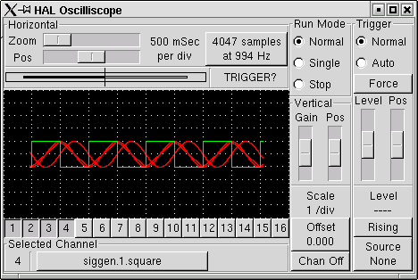

Now that we have several probes hooked to the HAL, it's time to capture some waveforms. To start the scope, click the ``Normal'' button in the ``Run Mode'' section of the screen (upper right). Since we have a 4000 sample record length, and are acquiring 1000 samples per second, it will take halscope about 2 seconds to fill half of its buffer. During that time a progress bar just above the main screen will show the buffer filling. Once the buffer is half full, the scope waits for a trigger. Since we haven't configured one yet, it will wait forever. To manually trigger it, click the ``Force'' button in the ``Trigger'' section at the top right. You should see the remainder of the buffer fill, then the screen will display the captured waveforms. The result will look something like figure [*].
Figure: Captured Waveforms
Image halscope-demo-4
The ``Selected Channel'' box at the bottom tells you that the green trace is the currently selected one, channel 4, which is displaying the value of the pin ``siggen.1.square''. Try clicking channel buttons 1 through 3 to highlight the other three traces.

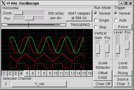

The traces are rather hard to distinguish since all four are on top of each other. To fix this, we use the ``Vertical'' controls in the box to the right of the screen. These controls act on the currently selected channel. When adjusting the gain, notice that it covers a huge range - unlike a real scope, this one can display signals ranging from very tiny (pico-units) to very large (Tera-units). The position control moves the displayed trace up and down over the height of the screen only. For larger adjustments the offset button should be used (see the halscope reference in section [*] for details).

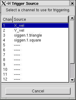

Using the ``Force'' button is a rather unsatisfying way to trigger the scope. To set up real triggering, click on the ``Source'' button at the bottom right. It will pop up the ``Trigger Source'' dialog, which is simply a list of all the probes that are currently connected (Figure [*] ). Select a probe to use for triggering by clicking on it. For this example we will use channel 3, the triangle wave.
Figure: Trigger Source Dialog
Image halscope-demo-5
After setting the trigger source, you can adjust the trigger level and trigger position using the sliders in the ``Trigger'' box along the right edge. The level can be adjusted from the top to the bottom of the screen, and is displayed below the sliders. The position is the location of the trigger point within the overall record. With the slider all the way down, the trigger point is at the end of the record, and halscope displays what happened before the trigger point. When the slider is all the way up, the trigger point is at the beginning of the record, displaying what happened after it was triggered. The trigger point is visible as a vertical line in the progress box above the screen. The trigger polarity can be changed by clicking the button just below the trigger level display. Note that changing the trigger position stops the scope, once the position is adjusted you restart the scope by clicking the ``Normal'' button in the ``Run Mode'' box.
Now that we have adjusted the vertical controls and triggering, the scope display looks something like figure [*].
Figure: Waveforms with Triggering
Image halscope-demo-6

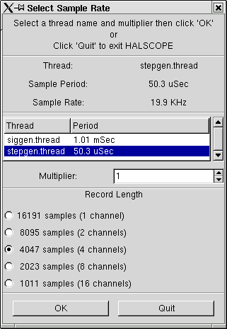

To look closely at part of a waveform, you can use the zoom slider at the top of the screen to expand the waveforms horizontally, and the position slider to determine which part of the zoomed waveform is visible. However, sometimes simply expanding the waveforms isn't enough and you need to increase the sampling rate. For example, we would like to look at the actual step pulses that are being generated in our example. Since the step pulses may be only 50uS long, sampling at 1KHz isn't fast enough. To change the sample rate, click on the button that displays the record length and sample rate to bring up the ``Select Sample Rate'' dialog, figure . For this example, we will click on the 50uS thread, ``fast'', which gives us a sample rate of about 20KHz. Now instead of displaying about 4 seconds worth of data, one record is 4000 samples at 20KHz, or about 0.20 seconds.
Figure: Sample Rate Dialog
Image halscope-demo-7

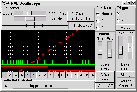

Now let's look at the step pulses. Halscope has 16 channels, but for this example we are using only 4 at a time. Before we select any more channels, we need to turn off a couple. Click on the channel 2 button, then click the ``Off'' button at the bottom of the ``Vertical'' box. Then click on channel 3, turn if off, and do the same for channel 4. Even though the channels are turned off, they still remember what they are connected to, and in fact we will continue to use channel 3 as the trigger source. To add new channels, select channel 5, and choose pin ``stepgen.1.dir'', then channel 6, and select ``stepgen.1.step''. Then click run mode ``Normal'' to start the scope, and adjust the horizontal zoom to 5mS per division. You should see the step pulses slow down as the velocity command (channel 1) approaches zero, then the direction pin changes state and the step pulses speed up again. You might want to increase the gain on channel 1 to about 20m per division to better see the change in the velocity command. The result should look like figure [*].
Figure: Looking at Step Pulses
Image halscope-demo-8
