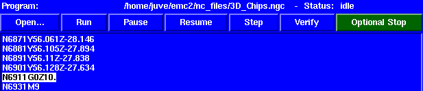

The buttons in the lower part of TkEMC (seen in Figure
are used to control the execution of a program: ``Open''
to load a program, ``Verify'' to check it for errors,
``Run'' to start the actual cutting, ``Pause''
to stop it while running, ``Resume'' to resume
an already paused program, ``Step'' to advance one
line in the program and ``Optional Stop''
to toggle the optional stop switch (if the button is green the program
execution will be stopped on any M1 encountered).
When the program is running, the line currently being executed is highlighted in white. The text display will automatically scroll to show the current line.
